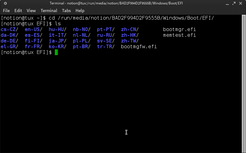

cd /run/media/"user"/"UUID"/Windows/Boot/EFI/then enter
Code: [Select]
lssearch for bootmfgw.efi

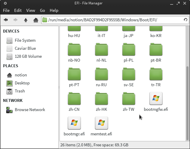

Or alternatively, you can use Thunar, you should see your Windows drive appear under devices on the left side pane, open it, open the Windows directory, open the Boot directory, and search for bootmgfw.efi , now just copy the path in the address bar in Thunar
